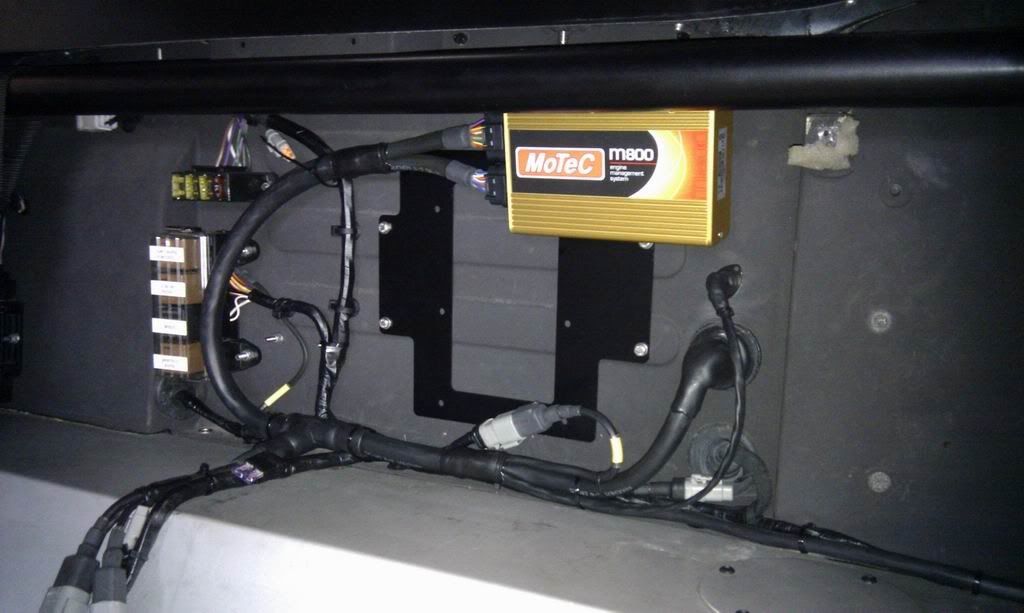

Re: Exige S1 190 ECU
Post by Esprit » Mon Oct 01, 2012 11:09 pm
That's mine, when it was in the car.
Slightly more expensive now!

Esprit
Posts: 949
Joined: Sat May 26, 2007 1:11 pm
Location: Auckland, New Zealand
Post by Esprit » Tue Oct 02, 2012 10:48 am
Excuse the bracket for the MoTeC... that was one I made up to hold a Link G4 computer before I changed to the M800... the proper bracket that's in the car now is a lot tidier :)
pete757
Posts: 3519
Joined: Wed Sep 27, 2006 1:50 pm
Location: Perth OZ
Post by pete757 » Wed Oct 03, 2012 1:44 am
Excused!!!
Blimey George!!! You are a total perfectionist!!! I presume all of this is still hidden out of sight behind the Plastic bulkhead!!! ;)
